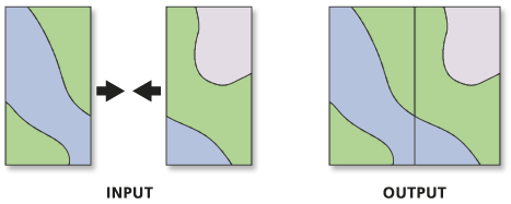

Combines input features from multiple input sources (of the same data type) into a single, new, output feature class. The input data sources may be point, line, or polygon feature classes or tables.
Illustration
Usage tips
Use Merge when there are features from multiple input sources that need to be combined into one feature class.
Input data sources need not be adjacent; overlap is allowed.
The type of input data, such as polygons or tables, must be the same for all inputs.

Merge does not perform edge matching. There will be no adjustment to the boundaries of features. Edge matching can be performed in ArcMap or ArcINFO Workstation only.
Unlike the Union function, Merge does not planarize the input features into a single output. Input features from all the input feature classes remain intact in the target feature class.
