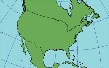

Description
This projection shows the true distance from either of two chosen points to any other point on a map.
Illustration of the Two-Point Equidistant projection

Correct from either of two chosen points to any other point on the map. Straight line from either point represents the correct great circle length but not the correct great circle path.
Limitations
Does not represent great circle paths.
