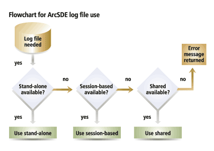

The diagrams in this section demonstrate the order in which ArcSDE will try to use log files. ArcSDE checks for pools of stand-alone or session log files before checking for individual ones.
ArcSDE log file flowchart

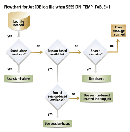

If you are using a SQL Server database and the SESSION_TEMP_TABLE parameter is set to 1, the following process is followed:
ArcSDE log file with session_temp_table true
