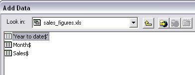

The following example contrasts how a multi-sheet document is exposed in Microsoft Excel and in the ArcMap Add Data dialog box.
- Three worksheets as they appear on the Sheet tab bar at the bottom of the Excel window:
- Available worksheets inside the sales_figures workbook on the ArcMap Add Data dialog box:
