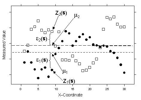

s)} in an attempt to do a better job. For example, the following figure has the same data that was used for Ordinary Kriging, only here a second variable is added.
Notice that the data Z
1 and Z
2 appears autocorrelated. Also notice that when Z
1 is below its mean µ
1, then Z
2 is often above its mean µ
2, and vice versa. Thus, Z
1 and Z
2 appear to have negative cross-correlation. In this example, each location
s had both Z
1(
s) and Z
2(
s); however, this is not necessary, and each variable type can have its own unique set of locations. The main variable of interest is Z
1, and both autocorrelation and cross-correlation are used to make better predictions.
