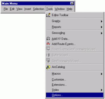

To access the geoprocessing settings, click the Tools menu on the Standard toolbar of the application you are working in and click Options, then click the Geoprocessing tab.

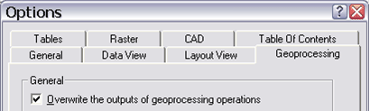

Overwriting tool output
The first choice you should see is the Overwrite the outputs of geoprocessing operations check box. By checking this option, all tools will automatically overwrite any existing output when run. With this option off, the tool will generate error messages if the output exists.

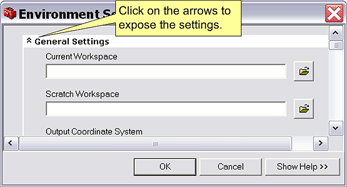

Change the current and scratch workspace
In the environments window, open General Settings by clicking the down arrows next to General Settings. The Current and Scratch workspaces should be the first settings.
