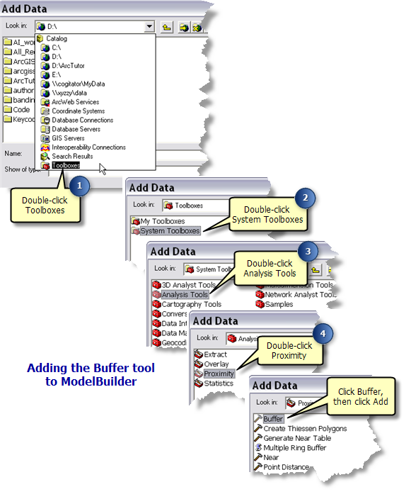

  2. In this step, you will be adding the Buffer tool. Click Add Add Data or Tools on the ModelBuilder toolbar. In the Add Data dialog box, navigate to Toolboxes > System Toolboxes > Analysis Tools > Proximity as illustrated below. Click Buffer, then click Add. (An alternative to this method is to drag and drop the Buffer tool from the ArcToolbox window onto the ModelBuilder canvas.)
  3. Adding the Buffer tool

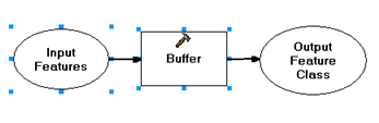

  4. The ModelBuilder canvas should now appear as follows:
  5. Model with Buffer process
    ModelBuilder canvas after adding the Buffer tool

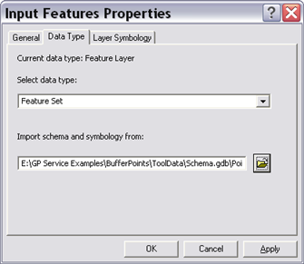

  10. Right-click Input Features and click Properties. In the Input Features Properties dialog box, click the Data Type tab.
  11. In the Select data type drop–down list, illustrated below, choose Feature Set. In the Import schema and symbology from text box, enter BufferPts/ToolData/Schema.gdb/Points, the point feature class you created in the above steps.
  12. Data type properties
  13. Click OK. The Input Features variable will now be a blue color.

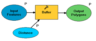

  26. Right-click Input Features and click Model Parameter. P (for Parameter) will appear next to the variable.
  27. Right-click Distance and click Model Parameter. P (for Parameter) will appear next to the variable.
  28. Right-click Output Polygons and click Model Parameter. P (for Parameter) will appear next to the variable.
  29. The model should now appear similar to the illustration below.
  30. Completed model

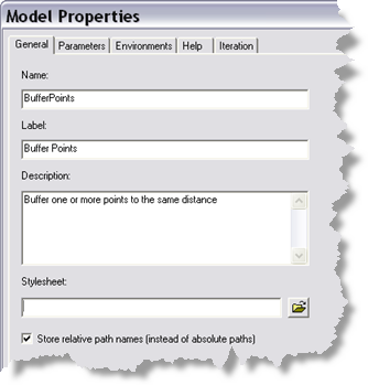

  31. In the main ModelBuilder menu, click Model, then click Model Properties.
  32. The illustration below shows these settings.
    Model Properties
  33. Click OK.

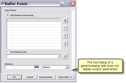

  9. Double-click Buffer Points. (Optionally, you can right-click Buffer Points and click Open). This will open the Buffer Points tool dialog, as illustrated below. (The illustration uses c:\arcgis\ArcTutor\Map\airport.mxd as the map.)
  10. Buffer Point tool dialog
  11. Click Add feature Add feature to add a point feature to buffer. You can add more than one feature.

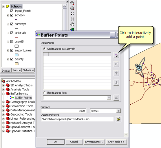

  8. Double-click Buffer Points. (Optionally, you can right-click Buffer Points and click Open). This will open the Buffer Points task dialog, as illustrated below. Note that unlike the Buffer Points tool dialog (shown above) when you tested your model, this dialog does not show the Output Polygons parameter. This is because ArcGIS Server will write the output polygons to a location on the server (defined by %scratchworkspace%) and there is no need for you to specify an output location.
  9. BufferPoint task dialog box
  10. Click Add feature Add feature to add a point feature to buffer. You can add more than one feature.
  11. Learn more about using the feature set control to add features

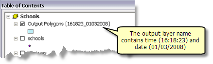

  16. It should only take a few moments for the task to complete. A new layer will be added to the ArcMap table of contents. This layer will be named Output Polygons [<time>_<date>], as illustrated below.
  17. Output Polygons layer
