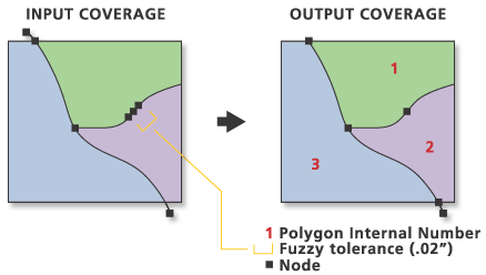

NOTE: This tool only works with an ArcInfo license and will only be available in ArcToolbox if you have installed ArcInfo Workstation.
Generates a coverage with correct polygon or arc-node topology. To do this, Clean edits and corrects geometric coordinate errors, assembles arcs into polygons, and creates feature attribute information for each polygon or arc (that is, creates a PAT or AAT).
While processing, Clean
Learn more about how Clean works.
Illustration
