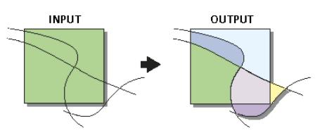

Creates an output polygon feature class from input line and/or polygon features. If lines are used as inputs, each distinct "closed" area will be a feature in the output polygon feature class.
Illustration
Feature to Polygon
