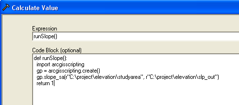

It is even possible to create the geoprocessor in the code block and use it to run other tools.
