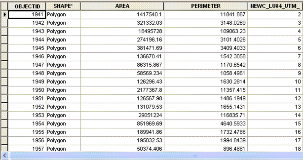

A feature class is stored as a table. Each row represents one feature. In the polygon feature class table below, the Shape column holds the polygon geometry for each feature. The value Polygon is used to specify that the field contains the coordinates and geometry that defines one polygon in each row.
