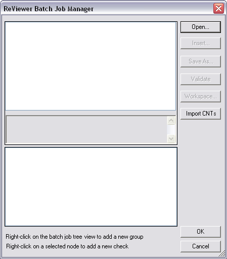

Creating a new batch job
- Start ArcMap.
- Click the ReViewer Batch Job Manager button
on the PLTS GIS Data ReViewer toolbar.
The ReViewer Batch Job Manager dialog box appears.
- Right-click the blank area at the top of the dialog box and click New Group.
A new group appears in the field.
- Click the group name to make it editable.
- Type a new name for the group and press Enter.
- Right-click the group, point to Add Check, point to the category that contains the check to be added, then click the check name.
The check's properties dialog box appears.
- Configure the parameters for the check.
Learn more about the individual checks
- Click OK.
- Repeat steps 6–8 for each check to be included in a group.
- Repeat steps 3–5 for each group to be added for a batch job.
- When you are finished creating groups and adding checks, click Save.
The Save As dialog box appears.
- Type a name for the batch job in the File name text box.
- Click Save.
- Click OK.

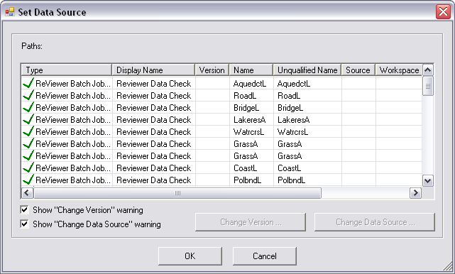

Changing the workspace
- Open a batch job.
- Click Workspace.
The Set Data Source dialog box appears.
- Click a row in the Paths table.
- Click Change Data Source.
The Select Data Source dialog box appears.
- Navigate to the feature class in the Name field.
- Click OK.
A message appears asking whether you want to change all matching paths.
- Click Yes to change the workspace for all feature classes.
NOTE: To change only one path, click No.
The paths are changed accordingly in the Workspace Path column.
- Click OK.
- Save the batch job.
- Click OK.
- You can also change the workspace for an individual group or check by right-clicking the group or check, clicking Open Data Source Dialog, then following steps 4–8 above. Click No when asked whether you want to change all matching paths.
