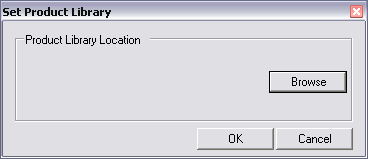

  2. The Set Product Library dialog box appears.
    If a product library has already been specified, the Update Workspace message appears. Proceed to step 6.
  3. Click Browse.

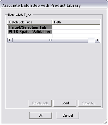

  14. The Associate Batch Job with Product Library dialog box appears.
  15. Click the cell to the right of Target/Selection Tab.
  16. Click Load.

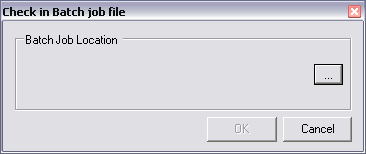

  17. The Check in Batch job file dialog box appears.
  18. Navigate to the Target/Selection Tab batch job you want to associate with the product class.
  19. Click Open.
  20. The Check in Batch job file dialog box appears.
  21. Click OK.
  22. The Associate Batch Job with Product Library dialog box appears.
  23. Repeat steps 9–13 for the PLTS Spatial Validation batch job.
  24. Click OK.

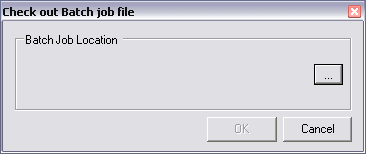

  5. The Check out Batch job file dialog box appears. If you have previously checked out a batch job, the path appears in the Batch Job Location area.
    Check Out Batch Job File
  6. Click the ellipsis (...) in the Batch Job Location area.
  7. The Browse For Folder dialog box appears.
  8. Navigate to the directory you want to use as the check out location.
  9. Click OK.
  10. The Check out Batch job file dialog box appears with the path to the directory you chose.
  11. Click OK.
  12. The Associate Batch Job with Product Library dialog box appears. A copy of the batch job is saved in the location specified on the Browse For Folder dialog box.
