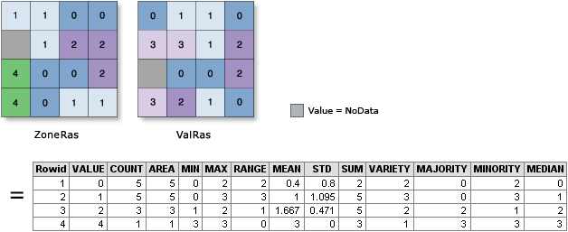

Illustration
ZonalStatisticsAsTable ZoneRas VALUE ValRas OutTable

An example of the output table is:
VALUE COUNT AREA MEAN MIN MAX ... 0 5 125.0000 0.6 0.0 .0 ... 1 5 125.0000 1.0 0.0 3.0 ... 2 3 75.0000 1.667 1.0 2.0 ... 4 2 50.0000 3.0 3.0 3.0 ...
