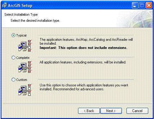

Here's an example picture of the ArcGIS Desktop Setup dialog:
Install the Data Inteoperability Extension using "Complete" or "Custom."
By checking on Complete, you will install all optional extensions to ArcGIS Desktop.
By checking on Custom, you can choose the subset of extensions you wish to have installed on your computer. To support GML and WFS, you will want to ensure that you have enabled the Data Interoperability extension to be installed.

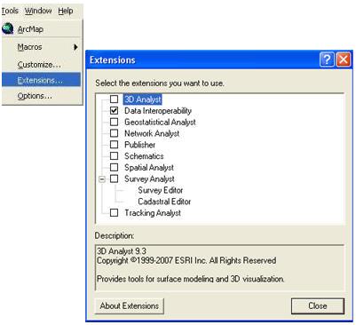

Once you have installed this extension, you can access and use GML and WFS in ArcCatalog, ArcMap, and other Desktop applications by turning this extension on.
Steps
  1. From the Main menu in ArcCatalog, ArcMap, and so on, choose "Extensions . . ." in the Tools pulldown.
  2. Be sure to turn on the Data Interoperability extension as shown below.
Enabling the Data Interoperability extension
