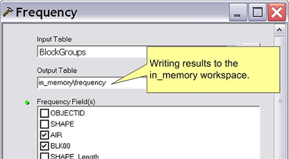

The example below shows using in_memory with the
Frequency tool.

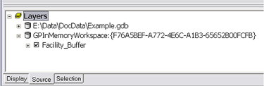

In_memory source location
A table or feature class based on data written to the in_memory workspace will have the source location of GPInMemoryWorkspace, as shown in the following illustration from ArcMap:
The long string of characters enclosed in brackets {} following GPInMemoryWorkspace is a unique identifier created and used by ArcGIS.
