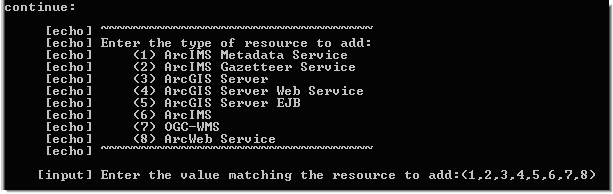

Configure a Metadata Service
- Enter "2" to choose the ArcIMS Metadata Service for this
Metadata Explorer.
- Enter the server location where the Metadata Service resides.
- If you are connecting through your network using TCP, input the
server name.
- If you are connecting through HTTP, input the full URL.
- If you are using a TCP connection, input the ArcIMS Application
Server port number. The default value is 5300. Otherwise, add
nothing and press Enter.
- Input the Metadata Service name. The name is case sensitive.
- At the prompt asking if you want to add another resource, enter
"y" unless you do not plan to include a Gazetteer or Search Map
service. In this case, enter "n".

- Enter "2" to choose the ArcIMS Metadata Gazetteer Service.

- Enter "6" to choose the service.
