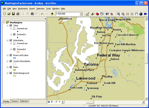

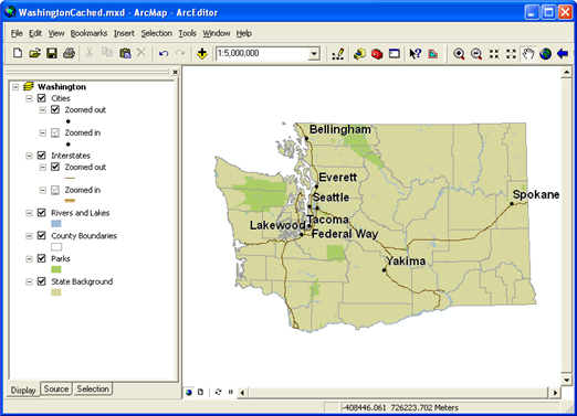

The images below show an ArcMap document that has been symbolized for viewing at two scales. The author of this map copied and pasted the Interstates and Cities layers back into the data frame, then symbolized a "Zoomed in" and "Zoomed out" version for each layer.
In the zoomed out map, the author set a definition query to limit the visible cities to those with a population of more than 50,000. Also, the author symbolized the Interstates layer with a thin line.
In the zoomed in map, the author removed the definition query so that all cities are visible. However, the author added label rules that symbolize larger cities with a larger font. The author also changed the Interstate symbolization to use a thicker cartographic line symbol.
The author set scale ranges on both the "Zoomed in" and "Zoomed out" layers to ensure that only one of the layers is visible at any given scale. The Rivers and Lakes, County Boundaries, Parks, and State Background layers use the same symbol whether zoomed in or out, so the author did not create copies of these layers.

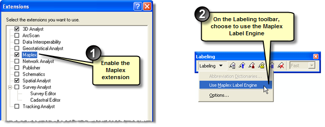

Use the Maplex labeling engine in your map document. This will give you the best possible label placement while caching.

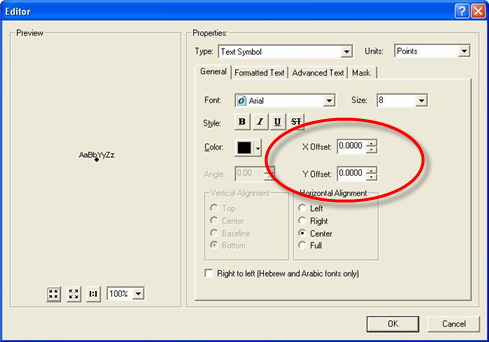

Set X Offset and Y Offset values on text symbols to 0. Using text symbol offsets may result in periodic inadvertent label truncation. Use the label engine's offset ability instead.

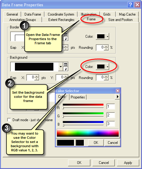

Explicitly define a data frame background color not used elsewhere in your map (RGB 254,255,255 is a good choice). Otherwise, any symbols and text that happen to be the same as the background color may be rendered improperly when the background is interpreted as transparent in certain browsers.
You can explicitly set the background color in ArcMap. The background will render as transparent in environments that support PNG 24 transparency.

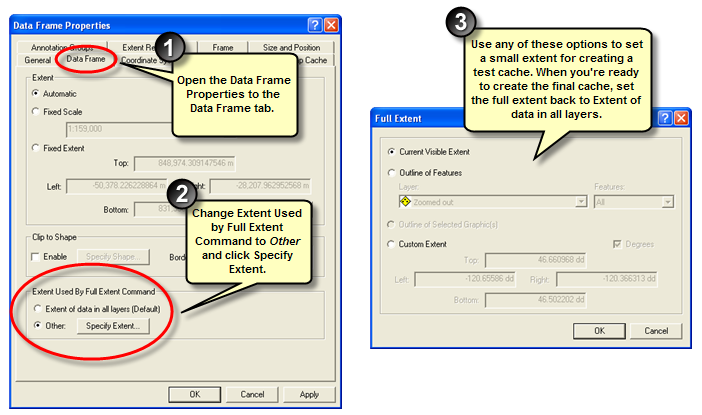

Before starting a large caching job, make a test cache of a small area at all scale levels. You can do this by setting a custom full extent on the source map document that covers a small geographic area. When you've created the cache for this small area, examine the tiles to make sure they look and perform the way you expect. One way to do this is to create a simple Web Mapping Application in Manager that uses the service.
When you're satisfied with the test cache, delete it, reset the full extent to the original extent, and cache the whole map.
