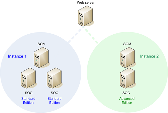

All SOC machines associated with a SOM must have the same edition (Basic, Standard, or Advanced) of ArcGIS Server installed. For example, if a SOM has three SOC machines associated with it, all three of those SOCs must have the same edition of ArcGIS Server.
To create a new configuration of SOM and SOCs in your ArcGIS Server system, you can add a new instance of ArcGIS Server. Instances are explained in How the GIS server works.
