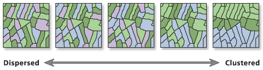

Measures spatial autocorrelation based on feature locations and attribute values.
Learn more about how Spatial Autocorrelation: Moran's I works
Illustration
Usage tips
Given a set of features and an associated attribute, Global Moran's I evaluates whether the pattern expressed is clustered, dispersed, or random. When the Z score indicates statistical significance, a Moran's I value near +1.0 indicates clustering while a value near – 1.0 indicates dispersion.
