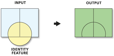

Computes a geometric intersection of the Input Features and Identity Features. The Input Features or portions thereof that overlap Identity Features will get the attributes of those Identity Features.
Learn more about how Identity works
Illustration
Identity illustration
