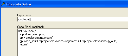

Generally, users will type their expressions in the Expression parameter. More complicated expressions such as multiline calculations or logical operations (if, then etc) will require the use of the code block parameter. The Code Block parameter, cannot be used on its own, it must be used in conjunction with the Expression parameter.
Variables defined in the Code Block parameter can be referenced from the expression.
Functions can be defined in the Code Block and called from the Expression. In the example below our function will return a string wind direction based on a random input value. In Python functions are defined using the "def" keyword followed by the name of the function and the function's input parameters. In this case, the function is called "getWind" and has one parameter called wind. Values are returned from a function using the "return" keyword.
In python, part of syntax is white space. The amount of white space does not matter as long as it is consistent throughout the code block.
It is even possible to create the geoprocessor in the code block and use it to run other tools.
You cannot access model variables from the code block. Such variables must be passed to the code block from the expression. This can be achieved by creating a definition in the code block and referencing the definition in the expression.
