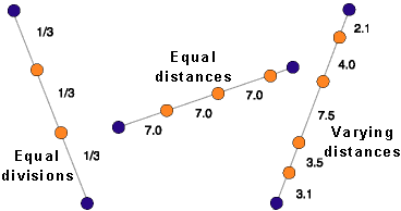

Different methods for computing these coordinates are available.
They can be computed at equal distances along the path, at varying distances, or so that they divide the given path into a specific number of equal lengths.
Divisions and distances
When using the variable distances method, you can choose to enter a closing distance. This is the distance from the last point computed to the endpoint of the path.
The difference between the sum of all the distances that you enter and the path length is called the distance misclosure or remainder. You can choose to proportion this remainder for each distance and compute new coordinate locations for the points.
Misclosure
