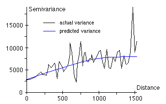

Below is an example of a typical semivariogram:
There are several important features worth noting in the plot of the sample semivariogram. At relatively short lag distances of h, the semivariance is small but increases with the distance between the pairs of sample points. At a distance referred to as the range, the semivariance levels off to a relatively constant value referred to as the sill. This implies that beyond this range distance, the variation in z-values is no longer spatially correlated. Within the range, the z-value variation is smaller when the pairs of sample points are closer together.

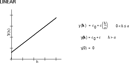

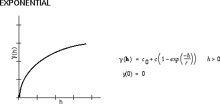

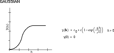

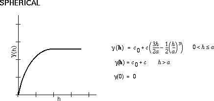

Below are the general shapes and the equations of the mathematical models used to describe the semivariance.
