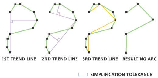

POINT_REMOVE applies a published algorithm (Douglas and Peucker, 1973) with enhancements. It is a fast, simple line simplification algorithm. It keeps the so-called critical points that depict the essential shape of a line and removes all other points. The algorithm connects the endpoints of a line with a trend line. The distance of each vertex to the trend line is measured perpendicularly. Vertices closer to the line than the tolerance are eliminated. The line is then divided by the vertex farthest from the trend line, which makes two new trend lines. The remaining vertices are measured against these lines, and the process continues until all vertices within the tolerance are eliminated (see the diagram below).
Simplify Line example 2
