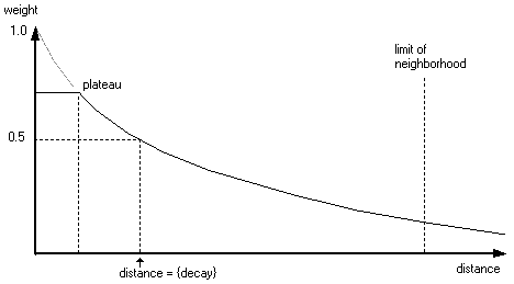

When a {plateau} distance greater than zero is used, any distance di less than the {plateau} is replaced by the {plateau} distance in the calculations. The difference between the IDW and exponential weighting methods can be seen in the graphs below.
PointInterp IDW weighting function
The figure above shows a simplified graph of the nonsmoothed IDW weighting function. The weight is constant from distance 0 to the {plateau} distance. The gray dashed line shows the weight without a {plateau). At the limit of the neighborhood, the weighting function is not 0. With the SMOOTH option, the weighting function would reach 0 exactly at the edge of the neighborhood.
PointInterp EXP weighting function
The figure above shows a simplified graph of the nonsmoothed Exp weighting function. The gray dashed line shows the weight without a {plateau}, while the solid line shows the weight with a {plateau}.
