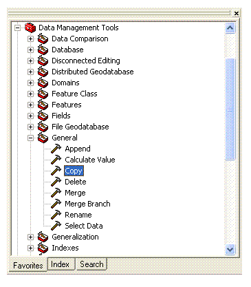

The primary mechanism used to copy a geodatabase using geoprocessing is by using the Copy tool in geoprocessing. This tool is found in the Data Management Tools toolbox in the General toolset.
The Copy tool can be used to make a copy of an existing geodatabase of the same type (for example, to make a copy of a file geodatabase). Both the schema and all the contents of the geodatabase will be copied.

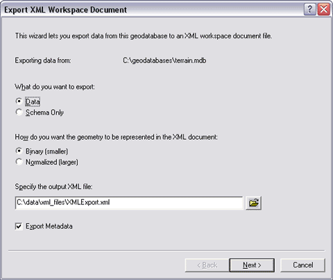

- In the ArcCatalog tree, right-click the geodatabase that you want to copy and point to Export. Click XML Workspace Document.
- On the first panel of the wizard, click Data since you want to copy all the geodatabase contents.
- Specify the path and name of the new export file you will create.
- If you specify the path and name by typing it into the text box, give the file a .xml, .zip, or .z extension to specify the file type.
- If you specify the path and name by browsing to a folder with the Save As dialog box, specify the file type in the Save As dialog box.
If the data you're exporting has metadata and you want to export it, check the Export Metadata check box.

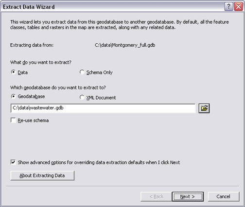

- Click the Extract Data button on the Distributed Geodatabase toolbar to start the Extract Data wizard.
- Since you want to copy all the contents, click Data in response to What do you want to extract?
- Navigate to the new geodatabase into which you want to copy the data, or type its path.
- To create a new file geodatabase, include the .gdb file name extension.
- To create a new personal geodatabase, include the .mdb file name extension.
- To copy the contents to a new ArcSDE geodatabase, you must first create it before using the Extract Data Wizard. See Creating an ArcSDE geodatabase.
- Check the Show advanced options for overriding data extraction defaults when I click Next option at the bottom of the page.

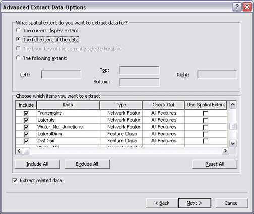

- Click Next to Specify the contents to be copied. On this panel, you can set the extent of the features to be copied and make a list of the data items whose information will be copied.
- If you want to copy all of the contents, check The full extent of the data. Note that you must not have any feature or table selections to copy all of the data contents within the extent.
- Uncheck the Include check boxes for the feature classes, tables, or relationship classes whose contents you don't want to export.
If you leave a box checked for a feature class in a network, topology, or terrain, the contents for all of the feature classes participating in the network, topology, or terrain will be copied. Click Next.

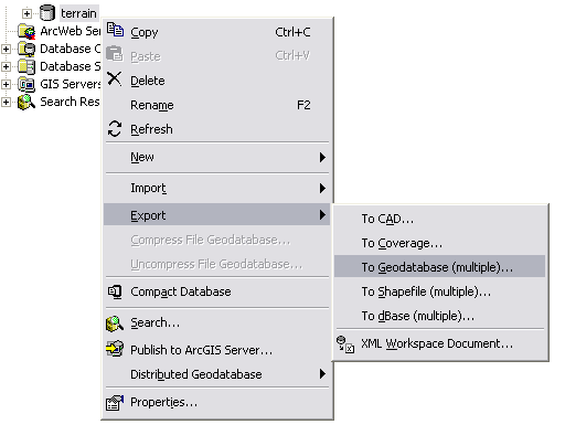

Copying feature classes using Export

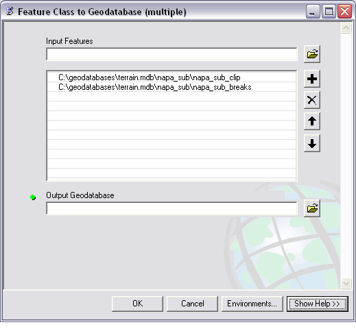

You can copy a series of geodatabase feature classes from one geodatabase to another using the Export tool. Right-click on the name of the geodatabase that contains the feature classes you want to copy, point to Export and click To Geodatabase (Multiple).
This will invoke the geoprocessing tool Feature Class to Geodatabase (multiple).
This tool will create a list of all feature classes, and you can add or remove some of the feature classes. By default, all of the feature classes in the existing geodatabase will be automatically copied unless you modify the list of feature classes.
You'll need to type the name of an existing geodatabase into which the feature classes will be copied.
