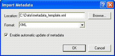

By default, after importing, ArcCatalog will update as many metadata elements as possible with values derived from the item's properties, such as its coordinate system.
Importing with the "XML" importer copies metadata content to the selected item
However, if you uncheck Enable automatic update of metadata in the Import Metadata dialog box, ArcCatalog won't overwrite any existing values. The "FGDC" and "ISO" stylesheets use an asterisk to show which elements have values that were updated automatically. View an illustration

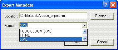

One way to contribute your metadata to some GIS catalog portals such as the U.S. Geospatial One-Stop is to export a copy of your metadata in XML format to a Web-accessible folder. The administrators of the metadata catalog may be able to harvest your metadata automatically. If you update your metadata regularly, harvesting your metadata on a regular schedule will ensure that the contents of the metadata catalog are always up to date. There are two options for exporting metadata in XML format—you can either use the "XML" importer, which makes an exact copy, or the "FGDC CSDGM (XML)" exporter, which exports FGDC metadata content only.
Exporting metadata in ArcCatalog

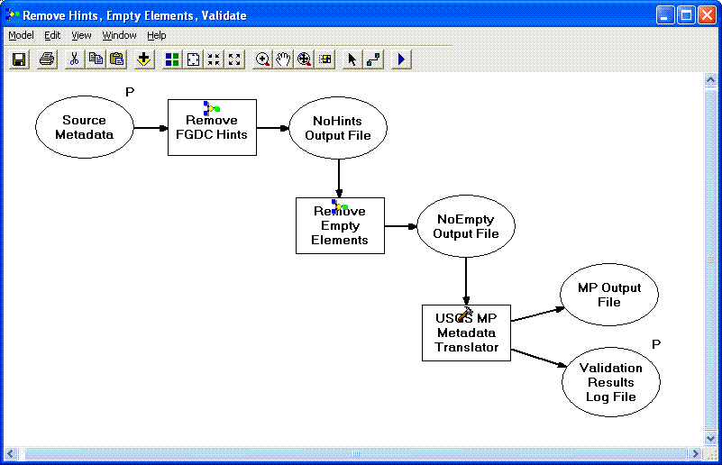

Another sample model runs the input metadata through XSLT style sheets that remove the FGDC documentation hints and remove empty metadata elements, then sends the results to the MP tool and produces validation results.
Validating FGDC metadata with geoprocessing model
