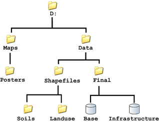

In the example directory structure below, assume you used Windows Explorer to navigate to D:\Data\Shapefiles\Soils. After navigating to this directory, a relative pathname will use D:\Data\Shapefiles\Soils as the current directory (until you navigate to a new directory, at which point the new directory becomes the current directory). The current directory is sometimes referred to as the root directory.
If you wanted to navigate to the Landuse directory from the current directory (Soils), you could type in the following in the Windows Explorer Address edit box:
..\Landuse
and Windows Explorer would navigate to D:\Data\Shapefiles\Landuse. A few more examples using D:\Data\Shapefiles\Landuse as the current directory are
.. (D:\Data\Shapefiles)
..\.. (D:\Data)
..\..\Final (D:\Data\Final)
. (D:\Data\Shapefiles\Landuse - the current directory)
.\..\Soils (D:\Data\Final\Soils)
..\..\.\Final\..\Shapefiles\.\Landuse (D:\Data\Shapefiles\Landuse)
NOTE: A relative path cannot span disk drives. For example, if your current directory is D:, you cannot use relative paths to navigate to any directory on E:

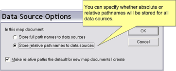

You cannot enter relative pathnames using the dot/double-dot notation described above in any ArcGIS desktop application. However, when you create an ArcMap (or ArcScene or ArcGlobe) document, you can specify that pathnames will be stored as relative pathnames. (Absolute pathnames are the default.) To set this option, look under the File menu, click Document Properties, then click the Data Source Options button found on the lower right. This will open the Data Source Options dialog box, and you can specify whether to store absolute or relative paths.
When you save the document with relative pathnames, the application converts all pathnames into relative pathnames (using the dot/double-dot notation) in relation to the location where you stored the document. For example, if your document is stored in
D:\Maps\Posters\Newmap.mxd
and the data in one of your layers is
D:\Data\Final\Infrastructure.gdb\Streets
what gets stored in Newmap.mxd is
..\..\Data\Final\Infrastructure.gdb\Streets
When you open Newmap.mxd again, ArcMap converts the stored relative pathname from the dot/double-dot notation back into the absolute path representation, which is displayed as the data source for a layer. Note, however, that if you move Newmap.mxd to another directory, the data will not be found.

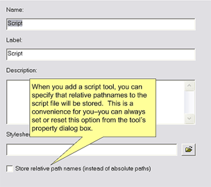

To store as relative paths, right-click the tool and click the General tab. At the bottom of the dialog box, check Store relative path names (instead of absolute paths), as shown below.
When you add a script tool, this option will also appear on the first panel of the Add Script wizard. Setting this option on the Add Script wizard is the same as setting it on the tool's property dialog box, so you can always reset this option when the Add Script wizard is completed.
