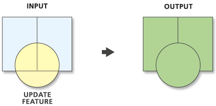

Computes a geometric intersection of the Input Features and Update Features. The attributes and geometry of the Input Features are updated by the Update Features. The results are written to the Output Feature Class.
Learn more about how Update works
Illustration
Update illustration
