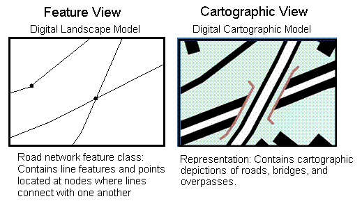

In the example above, you can see the geographic features for roads and how their cartographic representations in the map differ from the GIS feature geometry.

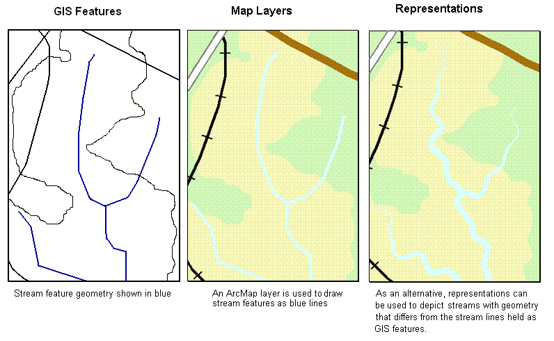

Below, you can see an example for how representations can be used to depict features differently from their feature geometry.
Stream features portrayed using enhanced geometry using representations
Cartographers often say that there are two views of geographic information -- the geographic view and the cartographic view. In the research literature, the geographic view is sometimes referred to as a digital landscape model in which features are accurately referenced to real-world coordinates and faithfully overlay image sources such as an orthophoto base. The cartographic view is referred to as a digital cartographic model in which map symbols and depictions are the primary means for communication and do not necessarily represent their real-world locations.
In maps, it's often more important to portray how features are placed relative to one another and to graphically communicate a set of relationships (such as the water goes under the bridge). This often requires a cartographic depiction that differs from the real-world location and shape of GIS features.
In ArcGIS, cartographic representations enable both digital models to be integrated in the geodatabase. Cartographic representations are stored as extra columns in the feature class attribute table and in system tables in the geodatabase. Also, you can have multiple cartographic representations for a single feature class. For example, you might have two sets of road representations -- one for transportation maps and another for tourist maps.
This means that you can have multiple cartographic representations for features without changing their underlying feature geometry (point, line, polygon, etc.).

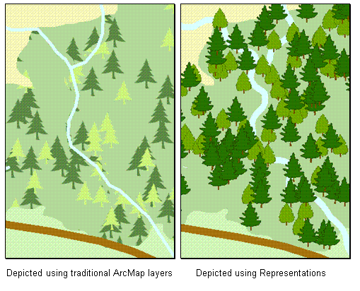

Cartographic representations are intended to handle a multitude of map depiction and portrayal issues in a GIS. Here are a few examples:
Some mechanism is required in the mapping system that will allow you to handle these situations without affecting the underlying GIS feature geometry.

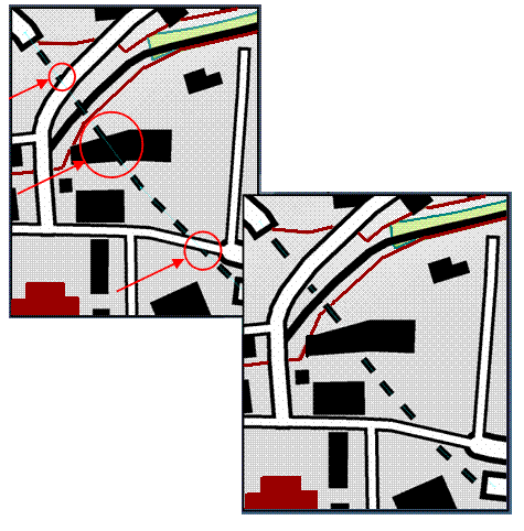

In addition to applying drawing rules and overrides to depict such mapping situations, you can also graphically edit representations to create high quality map products. Cartographers often refer to this work as "map finishing and editing". Traditionally, they have exported their GIS maps into a graphics package such as Adobe Illustrator to complete such work.
Representations in ArcMap also include a series of tools to perform graphical edits directly in the GIS without having to export the cartography to a graphics package. Here is one simple example that illustrates how dashed line graphics that represent the pathway of a tunnel need to be edited and cleaned up where they intersect buildings and roads:
Graphical edit and cleanup performed using representations in ArcMap
Since these edits are saved in the geodatabase, they can be delivered to all ArcGIS users in map documents and map servers.
