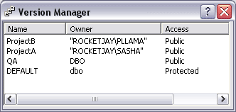

Below is the Version Manager dialog box accessed through ArcMap or ArcCatalog. It shows the DEFAULT version and three other versions: a quality assurance version (QA) and project versions, ProjectA and ProjectB.

In the example below, the QA version is a child of the DEFAULT version and ProjectA and ProjectB versions are children of the QA version.

In the versions example above, multiple editors could concurrently edit the ProjectA and ProjectB versions. You would likely have a smaller number of users making changes in the QA version.

As you can see in the Version Manager dialog box below, the DEFAULT version is protected and the other versions are public.

Based on the privileges assigned to the versions in the QA/Project example, a logical reconciling and posting workflow would go from the project versions to the QA version then to the DEFAULT version.

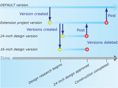

Versions: An example
To illustrate how versions can be used, follow this scenario from a municipal water utility. The water utility has a geodatabase of features representing the current state of all of the water pipes, valves, pumps, and other components of the water system. The utility needs to add a new line extension to the water system.
The utility creates a new version from the DEFAULT version called Extension project, which is to contain the design of the new extension. However, the utility staff are unsure whether to go with a 16-inch or a 24-inch|design for the new extension. So, from the Extension project version, they create a version to study the 16-inch design and another to study the 24-inch design.
They eventually discover the 24-inch|will serve projected water demand for 12 more years and that the greater initial construction cost is justified. The 24-inch design wins approval, is checked for accuracy, and posted to the Extension project version.
A few months later, the construction of the new line extension completes. To update the published version of the database, the Extension project version is reviewed for accuracy, reconciled, and posted to the DEFAULT version.
