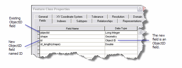

If you register with the geodatabase a feature class that already contains a field named ObjectID, an ID field is automatically added to the business table. This ID field's data type is Object ID. The field is populated with unique values for each record in the business table. These values are generated by the geodatabase.
Be aware that there can be only one field with a data type of Object ID in a feature class registered with the geodatabase. If the existing ObjectID field was registered with ArcSDE as a user-maintained ObjectID, the data type on the existing ObjectID field will be changed to Long Integer. If the existing ObjectID field was registered with ArcSDE as ArcSDE maintained, the existing ObjectID will be used for the ObjectID.
Feature class properties of a feature class registered with the geodatabase
