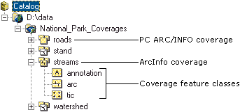

A coverage is stored as a directory within which each feature class is stored as a set of files. For example, a coverage will appear in ArcCatalog with the icons as shown below. In this example, you can see that the streams coverage is a line coverage containing an arc (line) file, annotation for the line, and a tic file. There are also two versions of coverage files.
Coverage icons in ArcCatalog
