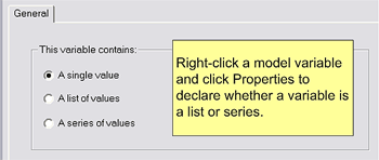

Declaring Lists and Series
In ModelBuilder, right-click any variable and click Properties. Click the appropriate button to declare the variable as either A single value (the default), A list of values, or A series of values.

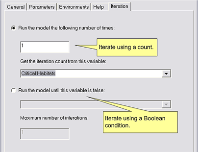

Setting up a model for iteration using a count or Boolean condition
From the Model menu in ModelBuilder, click Model Properties and click the Iteration tab. Here is where you specify that you want the entire model to iterate using a count or Boolean condition.
