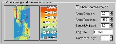

A Semivariogram Surface with Search Direction capabilities is given below. The values in the semivariogram cloud are put into bins based on the direction and distance between a pair of locations. These bin values are then averaged and smoothed to produce a surface of the semivariogram. Below, a color ramp is given along with the values on the borders between color transitions. You can input a lag size to control the size of the bin, and the number of bins is given by number of lags. The extent of the semivariogram surface is controlled by lag size and number of lags.
You can view subsets of values in the semivariogram cloud by checking the Show Search Direction box and clicking the direction controller to resize it or change its orientation.
