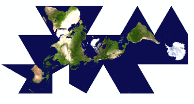

If that service layer is added to a data frame with a coordinate system not supported by the WMS server, such as World Fuller, ArcMap uses the image previously received from the server and projects it on the fly.
WMS service projected into the World Fuller coordinate system
Depending on the coordinate system being used by the data frame, there may be some level of distortion in the display of the WMS layer—most noticeably if the layer has text. The benefit of using only coordinate systems supported by the WMS server is that the image returned by the WMS server is not postprocessed to fit into an unsupported coordinate system.

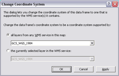

You can right-click a WMS service, group layer, or sublayer in the table of contents and click Change Coordinate System to view the server-supported coordinate systems. This dialog box allows you to change the data frame's coordinate system to one that is supported by the WMS service. If you launch this dialog box by right-clicking any group or layer inside the WMS service, it will only list the coordinate systems supported by the group or layer you right-clicked.
Changing to a server-supported coordinate system
If your map contains more than one WMS service, you can click the first option on this dialog box to choose a coordinate system that is supported by all the layers in all the WMS services in your map. Depending on which services you are accessing, you may find the situation where there is no coordinate system that is common to all the services.
The Change Coordinate System command can be used at any time, even if all the layers in the WMS service or services you are using support the data frame's current coordinate system. For example, you can use the Change Coordinate System command to choose a different coordinate system for your data frame. This will ensure that the coordinate system you choose will be one that is supported by all the WMS services in your map.
You can change the coordinate system of your map from the Data Frame Properties dialog box, but this doesn't limit your choices to those supported by WMS services in your map and may result in some or all the layers in these services being projected on the fly.

  1. Right-click the WMS service layer in the table of contents and click Change Coordinate System.
  2. Click a coordinate system from the drop-down list. If your map contains more than one WMS service, you can choose a coordinate system that is supported by all the layers in all the WMS services in your map.
  3. Click OK. The coordinate system for the data frame has now been changed.
Tip
  • Some WMS servers may support a large number of coordinate systems. In cases where the WMS server supports more than 1,000 coordinate systems, you will not be able to use the Change Coordinate System dialog box. To change the data frame's coordinate system to one that is supported by the WMS server, check the coordinate systems listed on the Source tab of the WMS sublayer and manually choose one of the coordinate systems listed on the Coordinate System tab of the Data Frame Properties dialog box. Also, if you have multiple WMS service layers and at least one of the services supports more than 1,000 coordinate systems, the "all layers from any WMS service in this map" option of the Change Coordinate System dialog box will be disabled.
