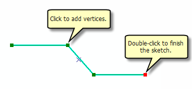

Sketch tool
Use the Sketch tool Sketch to create point features and digitize the vertices of line or polygon features. After you finish the sketch, ArcMap adds the final segment, and the sketch turns into a feature.
How to use the sketch tool

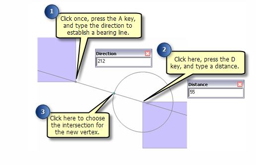

Direction-Distance tool
The Direction-Distance tool Direction-Distance allows you to create a vertex using a distance from a known point plus a direction from a known point to define a bearing line. For example, a pole might be located at a specified distance from the corner of one building and at a defined angle from the corner of another building.
Using the Direction-Distance tool

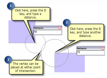

Distance-Distance tool
The Distance-Distance tool Distance-Distance lets you create a point or vertex at the intersection of two distances from two other points.
In the example below, the Distance-Distance tool is used to place a new electrical primary based on field measurements. The next point for the primary is known to be 50 feet from one building corner and 75 feet from another. The Distance-Distance tool creates two circles based on these distances and finds two possible intersection points where the primary can be placed.
Using the Distance-Distance tool

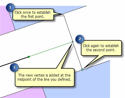

Midpoint tool
The Midpoint tool Midpoint lets you define the location of the next vertex by clicking two points; the new vertex is placed at the midpoint of the line between these points. If you were creating a road feature class from parcel data, you might use the Midpoint tool to create the vertices directly between the parcels on opposing sides of the road.
Using the Midpoint tool

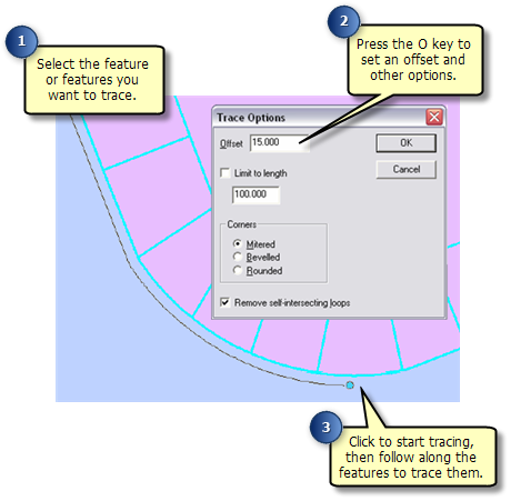

Trace tool
The Trace tool Trace helps you create segments that follow along existing segments. Suppose you want to add a new road casing feature that is offset 15 feet from the front of a parcel subdivision. You could use the Trace tool to trace along the existing line features instead of typing the angle and length of each segment. You'll need to select the parcel features before you can start tracing the road casing feature. The Trace tool only follows selected features.
Using the Trace tool
