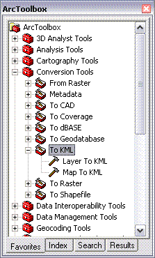

  1. Where are the KML geoprocessing tools?
  2. The Map To KML and Layer To KML geoprocessing tools are in the To KML toolbox inside the Conversion toolbox.
    The location of the KML geoprocessing tools
