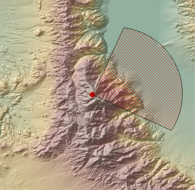

The image below shows that when you place an observer point in the data frame, the field of view will display around the point with its geometry based on the parameters set in the Radial Line of Sight dialog box.

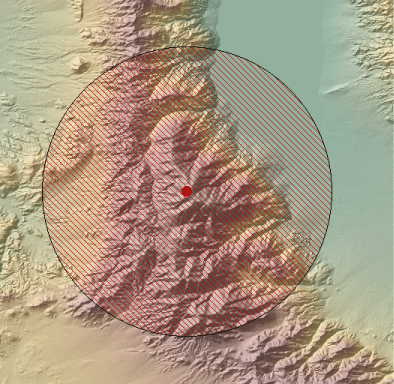

As the illustration below shows, when you type a starting value of 0 and an ending value of 360 in the Azimuth Range field, a circular field of view is generated. Any other value range will generate a partial circle. Only values from 0–360 are valid.

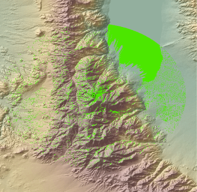

In the illustration below, a polygon shapefile was generated because the radial visibility was computed. The visible areas within the field of view are displayed as slightly transparent green polygons.
