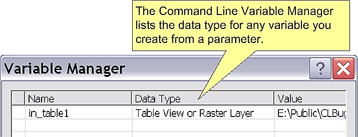

  2. In Command Line, when you create a variable with the Variable Manager, you need to provide a data type for the variable to be created.
  3. When adding a script tool, you need to provide the data type for each of the script tool's parameters.
In the case of ModelBuilder and Command Line, many users create variables from a parameter. Since all parameters have an associated data type, the variable is automatically created with the correct data type.
Learn how to create a variable from a parameter in ModelBuilder.
Learn how to create a variable from a parameter in Command Line.
