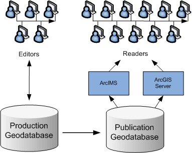

Production and Publication Geodatabases
An organization needs to support a group of editors as well as users accessing the system with read-only access. To satisfy the requirements of each group, the organization has two ArcSDE geodatabases. One is a production geodatabase, which is edited directly by the editors, while the other is a replica of this geodatabase and is accessed by the readers. Readers can access this data through ArcIMS or ArcGIS Servers.
In this scenario, the replica in the publication geodatabase is a read-only copy of the production geodatabase. The data on the publication geodatabase does not need to be versioned. The replication can be restricted to sending data in only one direction. Edits are made on the production geodatabase and are sent from it to the publication geodatabase. These edits are transferred and synchronized with the data on the publication geodatabase and then served to the readers.
