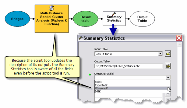

Updating the description of output data using the Schema object
In addition to customizing the behavior of the tool dialog and Command Line, you can use ToolValidator to update descriptions of output data variables for ModelBuilder. You can think of data variables in ModelBuilder as nothing more than brief descriptions of datasets, as illustrated below. Data variables contain every property you access using the geoprocessing object's Describe method.
All tools should update the description of their output data for use in ModelBuilder. By updating the description, subsequent processes in ModelBuilder can see pending changes to data before any process is run. The two examples below show how subsequent processes see pending changes.
The first example shows a model containing the Add Field and Calculate Field tools. In Add Field, the output data variable, Parks (2), is updated to contain the new field, TrackingID. Because the output is updated, the Calculate Field dialog shows TrackingID in the list of field names.
The next illustration shows a model where the output of the Clip tool is used as input to the Polygon to Raster tool. Since the Clip tool simply "cookie cuts" the input features, the output feature class has all the same properties as the input feature class with one notable exception: its geographic extent. The geographic extent of the output feature class is the geometric intersection of the input and clip features extents. The Polygon to Raster tool uses the new geographic extent to determine a default cellsize.

When you set the Schema.Clone property to true, you are instructing geoprocessing to make an exact copy (clone) of the description in the first dependent parameter in the parameter dependency list. Typically, you set Clone to true in initializeParameters() rather than updateParameters() since it only needs to be set once.
If the ParameterType of the output parameter is set to Derived, an exact copy is made. This is the behavior of the Add Field tool.
If the ParameterType is set to Required, an exact copy is also made, but the catalog path to the dataset is changed. Since most tools create new data, this is the most common behavior.
