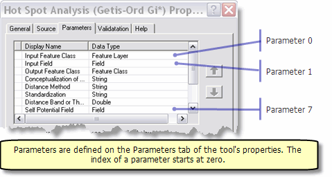

Order of parameters
A tool's parameters and their order are defined in the Parameters tab of the tool's properties, as illustrated below.
Parameters and their order
NOTE: The list of parameters is 0-based, so the first parameter is at position zero in the list. So, to access the third parameter
p3 = self.params[2]

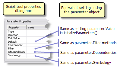

ToolValidator properties versus script tool properties
A parameter's default value, filter, symbology, and dependencies can be set in both the Parameters tab of the script tool's properties dialog and in the ToolValidator class, as illustrated below.
Overlap of parameter properties
Properties you set in ToolValidator always override those set in the script tool properties dialog box. For example, if you set the default value of a parameter to BLUE in the script tool properties dialog box and reset it to RED in initializeParameters(), the default value is RED. Once initializeParameters() has been called, the script tool properties dialog box will display RED as the default value. If you (or your users) get into the situation where the changes you make to one of these four parameter properties in the script's properties dialog box do not get saved, it is probably because the property is overridden within the ToolValidator class.

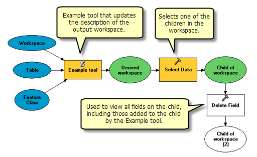

Following are some examples of setting a workspace schema. The examples are based on a script tool that has the following arguments:
Parameter name Properties
0 Input feature class Feature class—Input
1 Input table Table—Input
2 Input workspace Workspace—Input (an existing workspace that contains the results of the tool).
3 Derived workspace Workspace—Derived output, obtained from Input_workspace. The schema of this workspace is modified to contain additional children.
The tool takes the input feature class and table, copies both to the workspace, adds a new field to the feature class, then creates a new polygon feature class in the workspace. (The actual work of the tool isn't important as it only serves to illustrate setting a workspace schema.) The code examples below build on one another, starting with simple usage of AdditionalChildren. If you choose to implement and test some of the code examples below, you can test the code using the model illustrated below.
Model used to view results of validation
In initializeParameters(), the output workspace is cloned from its dependent parameter (parameter 2). This dependency is set in the tool properties but can also be set in initializeParameters() to guard against someone removing the dependency in the tool's properties.
