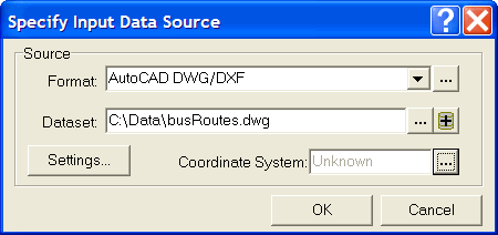

The Specify Input Data Source dialog appears:
Select the Source Format
Select the format of your source data. You can also click the Browse button to choose from the Formats Gallery.
Locate Source Data
Type the location of your input data. You can also use the buttons to browse for files or add multiple datasets. If the source format has specific default settings that you want to change, you can edit them here. For Settings Box Help: Press the Help button, the F1 button on your keyboard, or click the question mark in the upper-right portion of the Settings Box.
Coordinate System
By default, the Data Interoperability extension either uses a default value or uses the coordinate system referenced in the input dataset. For systems that know their coordinate system, this field will display "Read from Source” and the coordinate system will be read from the source dataset. For most other input sources, the field will display “Unknown” (which simply means that the default values will be used). In most cases, the default value is all you’ll need.
To specify a different coordinate system for the data, click the Browse button in the Coordinate Systems field to display the Spatial Reference Properties dialog. Refer to the ArcGIS Help files for more information on coordinate systems.
