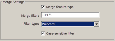

Merge Settings
  1. Click Feature Type Properties on an input feature type.
  2. The Feature Type Properties dialog appears.
  3. In the General tab under Merge Settings, check Merge feature type.
  1. Specify a Merge filter and a Filter type. The filter type can also be an Exact Match or a Regular Expression.
  1. Click OK to apply the properties to the feature type from which you initiated the Properties dialog.
    Click Apply to All to apply these properties to all input feature types (for example, if you add a bunch of attributes to one feature type, and you want other feature types to look the same).
When you run the translation, this pattern will be used to match against any incoming input feature types Matching input feature types will have their feature type "changed" to whatever the "known" feature type is.
Note: If a feature type matches more than one pattern, it will merge according to the first match.
For example, if you have a "PIPE145" feature type in your workspace as an input feature type, and you know there are many other feature types that have some sort of PIPE designation, you would click the Properties button, check the Merge Feature Type checkbox, and then enter a pattern that any incoming feature type would have to match in order to be considered the same as PIPE145. So, you could enter:
PIPE*
as shown in the example above. You can also uncheck the Case-sensitive filter so that even if an incoming feature type is "pipe" or "Pipe", it will be matched.
