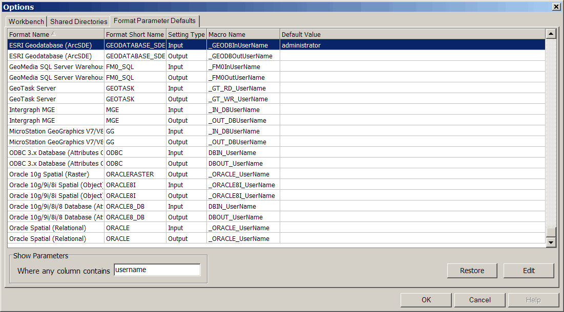

Select Options from the Tools menu and click the Format Parameter defaults tab.
In the Format Parameter Defaults dialog, you can filter the list so that you can see the setting that you want to adjust.
For example, if you want to set a default user ID, server name and password, you might want to search for "username" in the filter field.
Either double-click the selected field, or click the Edit button.

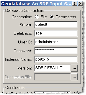

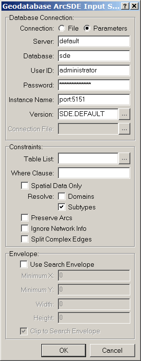

The Settings Box for the format appears. This example shows the input settings for the Geodatbase ArcSDE format.
NOTES:
Some formats have different input and output settings. Refer to the Setting Type column.
For some formats (e.g., database formats) you must enter a username, password, and server name before the defaults will be saved.
Enter the new default settings.
To register the changes, click OK in the Settings Box.
Your changes will appear in the Format Parameter Defaults Manager window.
Click Close to close the window.
