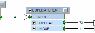

The feature count display shows how many features passed through each link. This function helps analyze the results of a workspace, and provides a reference for debugging if the destination results are not what you expected. Feature counts are also written to the Log file but you can find the references more quickly on the links in a workspace.
To enable feature count display, click the
Display Feature Counts tool
on the toolbar. Click
the tool again to turn off feature counts (although you will have to run
the workspace again to refresh the display).
In this example, you can see that 84 features entered the transformer and that 11 of the features had unique values.

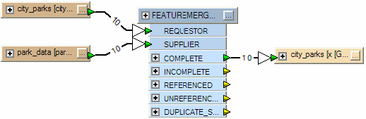

The example below shows the feature counts when spatial and non-spatial data is merged: 10 features from each stream are merged to form 10 output features.
