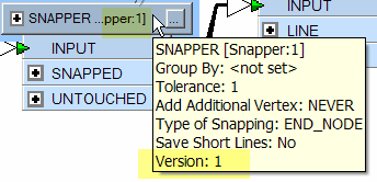

In FME 2007 (or newer) there is a setting in the Tools > Options (Transformers) for enabling the display of transformer versions. By default, the box is unchecked.
If you check the Show Transformer Version box, the workspace will display the transformer version in the transformer name (preceded by a colon), as well as in the tooltip that appears when you float the cursor over the transformer:
