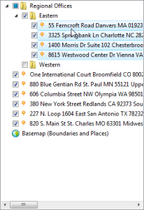

To select an adjacent range of items, select an item, hold down the Shift key, and then hold down the item at the end of the range; to select multiple, non-adjacent items hold down the Ctrl key while making each selection.

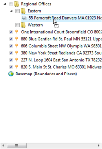

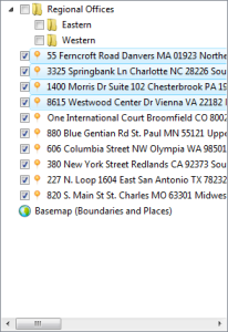

You can also organize related items (layers, results, links, etc.) into folders and you can order the items in a folder in any order you like. Click and drag the selected items to move them to a folder:
| A range of of adjacent items | ...dragged... | and dropped into a folder |
or right-click the selected item(s) to display a context menu and then click Move To Folder... to display a dialog listing all the folders.

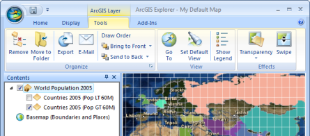

The items in a folder can be sorted alphabetically or by type. To sort the items in a folder, use the sorting buttons on the folder’s Tools tab in the Ribbon:
